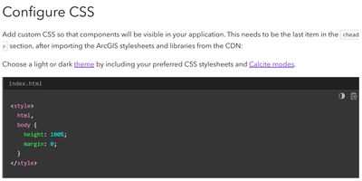

It appears that the screenshot below constitutes the complete and total extent of documentation for an entirely new framework, "@arcgis/core":
Actually, its apparent that this forum does not support screenshots, so I can only link you to the available documentation in question here
The documentation links to a repository with several rudimentary examples, none of which make even an attempt to document the API. I have deduced that the below code block should render a map, with a legend, zoom, and search bar, but unfortunately it doesn't.

Please adjust your attitude. This forum is maintained by volunteers, most are not ESRI employees. It is a place where professionals seek help from other professionals. I get that learning a new framework can be frustrating, but you won't get very far in the workforce with an attitude like that.
On the page you link, there is a very clear step stating that you must give your body and/or the Map Component a height in CSS or it will not be visible. I am 99% certain you did not do that. It is a common rookie mistake. I forget about it sometimes, too. I could have told you this yesterday, but your attitude put me off wanting to help.

I agree with your perspective on attitude and approach, but I strongly disagree with your assessment of the documentation linked.  Nothing on the "Configure CSS" page or sample indicates that a height:100% is required.  Coming from most other frameworks and documentation, that might as well be CSS boilerplate.

I may have been a little overly harsh on @Higgsy. They do have a point that the documentation on the documentation on the Component side of the API is a bit lacking, especially compared to the excellent documentation that we have been used to on the Widget based API.
As for your question, @D_Atkins, I believe the reason that Components require a CSS height is that they are loaded through the Virtual DOM and so have no inherit height or other CSS properties on the actual DOM, which is also why height: auto will not work either. The text in the screenshot does indicate that it is necessary to make the Components visible, but making this more prominent and providing an explanation would be good improvements to the documentation.
