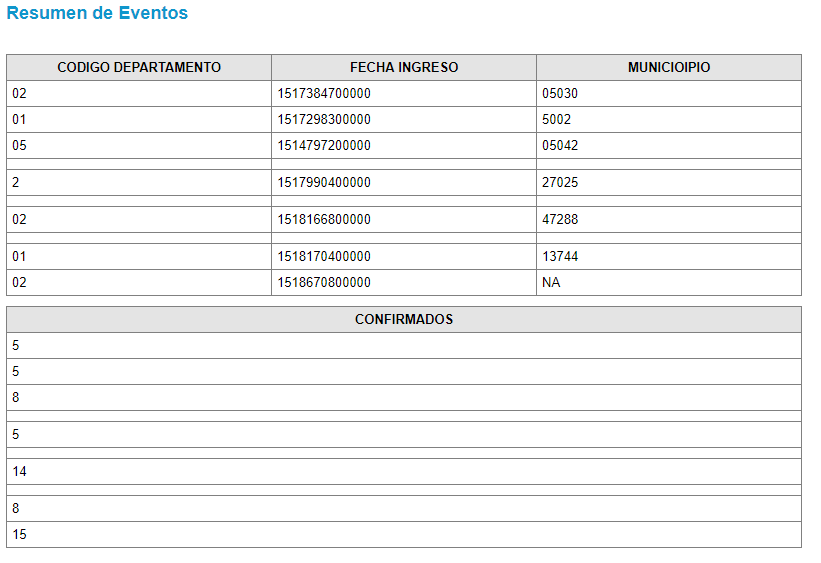

Hi Guys, i am deploying a report widget in web app builder, i guide by this code example,Report class—Web AppBuilder for ArcGIS (Developer Edition) | ArcGIS for Developers . I dont know when i change the table col size the table percist with the default value 3 Columos like i show in this example:
My Code looks like this i just copy the js file:

Here is a brutal way.
At the line 71 in the report.js (server/apps/your app folder/jimu.js/dijit/Report.js), change the default table columns to 4 or any number you need. the default is 3.
71     maxNoOfCols: 4 // to store table columns
or digest the function _formatAndRenderTables starting at line 551 in the Report.js and figure out how to overwrite the table cols.
551        _formatAndRenderTables: function (tableParentNode, reportData) {
                     var tableInfo = reportData.data;
                     var i, j, colsTempArray, rowsTempArray, chunk = this.maxNoOfCols;
                     //table cols can be overridden by setting in the table data properties
                     if (tableInfo.maxNoOfCols) {
                        chunk = tableInfo.maxNoOfCols;
So, the good way is to add the maxNoOfCols in the table data setting
      data: {
                  maxNoOfCols: 4,
         showRowIndex: false,
                  rows: [],
                  cols: [],
LiangJiang1

Juan_ManuelAngel_Cuartas
Thank you liang ! thats work great thank you very much, thats resolve a problem from my widget.
