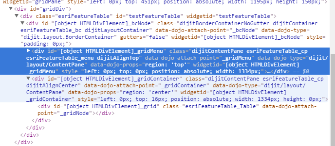

I can see that it is loading something, but I only seem to be getting the main grid container and some elements of the grid menu.  I'm thinking it could be something as basic as an error in the field names.  I keep paring those down, and maybe that's still where the problem
lies.

OK, I think I have the right combination now.  Fixing the versions of css and api combined with using an existing div, as opposed to creating a new one on the fly worked for me.
app.Table = new FeatureTable({
featureLayer: app.pointFLayer,
map: app.map},
'gridDiv');
