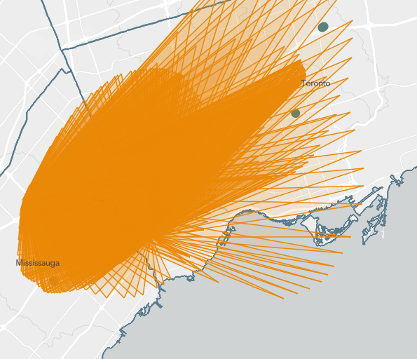

'If I don't do event.type === "draw-complete, my polygons end up following the cursor movement, like this;
@JoelBennett @Sage_Wall @UndralBatsukh
UndralBatsukh
Hi there,
Can you please clarify what the issue is here? I am not clear on what the end goal is.
Charan
Hi @UndralBatsukh so when Im drawing the polygons I cant see the shape of the polygon until I finish it off, but if i remove event.tuype=="drawing" i can see the polygons while drawing but they are being created based on cursor movement
UndralBatsukh
This codepen shows how to draw polygons using SketchViewModel: https://codepen.io/U_B_U/pen/WNmYRrV?editors=1000
