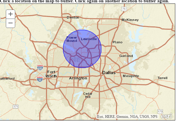

Hi everyone,
                 I am using this example for creating the buffer and passing the geometry into feature layer by using applyedits function.
 Now, I want to use editing widget tool but not need to change or add the vertices to that draw feature.  By passing the geometry to the featurelayer.applyedits function I cannot control on the geometry. Which say i can move the draw geometry into any direction. I need some help for how to achieve this.
Thanks for the help.
RobertScheitlin__GISP
MVP Emeritus
Sai,
   Here is the sample updated to use AMD style and adding mouse over editing to the buffers.

Sai_AnandPeketi1
Deactivated User
Thanks Robert.
But I want to save the Graphic in to my feature layer. How can we do this?
MVP Emeritus
You just use featurelayer.applyedits and pass in your new graphic.
