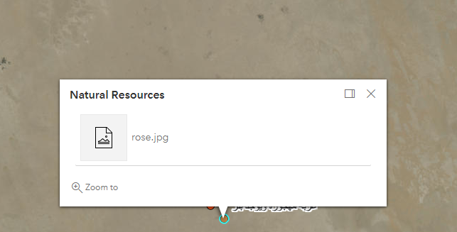

Trying to display the attachment image in Popup Template, but not able to display the full image . It shows only like a broken link image. But when clicked , it opens in new window and displaying like charm.
How can I display the full image it inside the popup , please
Thank you.

cadgism
Thank you Jayakumar PD
This is an attachment,  how do I specify the source URL here
let imageMediaInfoValue = new ImageMediaInfoValue({
  sourceURL: "<insert URL>"

cadgism
Solved. This is how it works. Your reply was helpful to solve this issue.
function showAtts(event){
  view.hitTest(event).then(function getGraphics(response) {
    if (response.results.length) {
      graphic = response.results[0].graphic;
      console.log(graphic);
      lyrUrl = graphic.layer.url + "/0/";
      objID = graphic.getAttribute('RemarkPoint.OBJECTID');
      attID = graphic.getAttribute('RemarkPoint__ATTACH.ATTACHMENTID');
      imgUrlPath = lyrUrl+objID+"/attachments/"+attID;
          sourceURL: imgUrlPath
      let imageElement = new ImageMediaInfo({
        title: "Natural Resources",
        caption: "Photo",
        value: imageMediaInfoValue
      let mediaElement = new MediaContent({
        mediaInfos: [ imageElement ]
      let template = new PopupTemplate({
        outFields: ["*"],
        showAttachments: true,
        content: [mediaElement],
      naturalServicepathF.popupTemplate = template;
