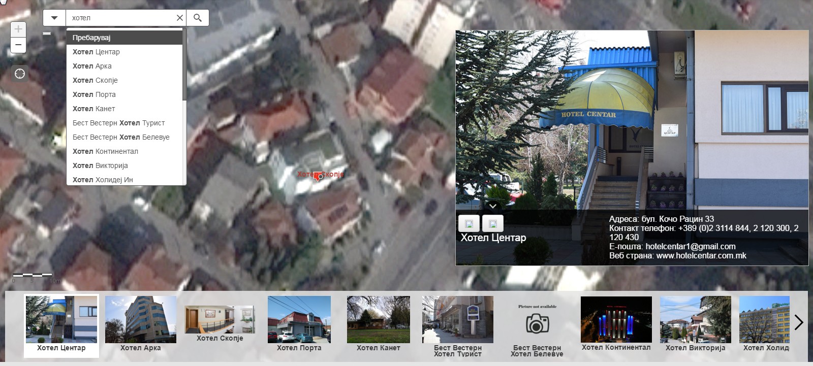

I have implemented the Search in the MapTour template.Works like it should, but i need to catch the event that push the results so i can put them in the MapTour points..Here is an example
So in short words i need the Search Result to be put in the point searched in the Template.So when the search is made the result should change the picture for the searched result.I im missing only the Search event that push the graphic on map.Regards

Goran,
  So are you just looking for the search-results event?
Search | API Reference | ArcGIS API for JavaScript
GoranTozievski
Deactivated User
For now yes ... Today i will try to pass the searcResult to the MapTour.. Thanks for the answer.
