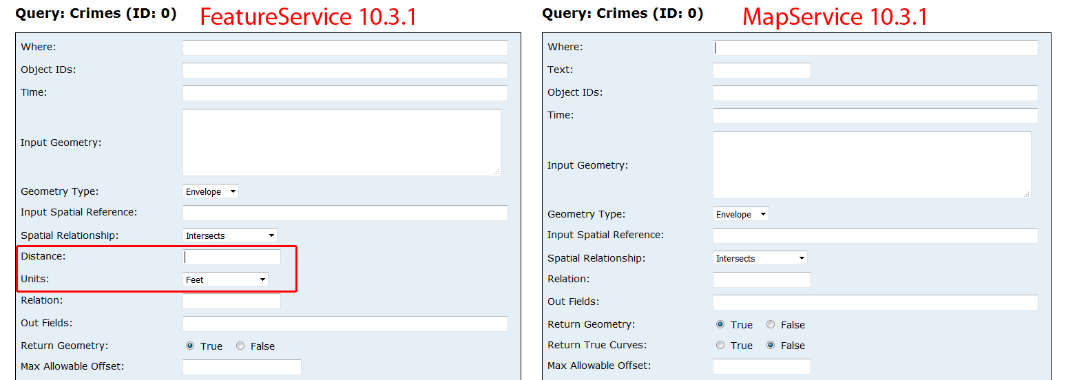

  You are using distance as part of the query. The 3.15 API docs say:
Distance to buffer input geometry. Query results will include features within the distance specified of the query.geometry. Valid only for hosted features services on arcgis.com. Optional. (Added at v3.9)
Which I believe this incorrect, but when I use my 10.3.1 ArcGIS Server and choose a Map Server and look at the rest end point distance is NOT an option on the query capability. But when I use a Feature Server distance is an option on the query capability. You need to check your code and make sure you are using feature server and not map server when switching to your production server urls.

Well that is interesting.
I'm definitely using a hosted feature service (in the sense that I'm hosting it) as shown in the URL in the code above:
"http://localhost:6080/arcgis/rest/services/data/device/FeatureServer/0"
But when I go into the Query screen of the rest endpoint for the feature service, it doesn't show Distance or Unit. This is the production server that is on 10.3.
