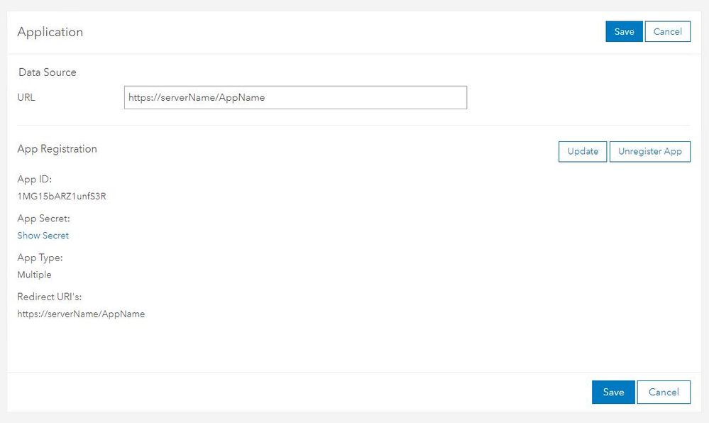

The answer is yes- I currently have 3 up and running behind our firewall and using Portal's authentication to access layers published through Portal and our organization's external ArcGIS Server.
It's not hard but ESRI's documentation isn't as clear as they think. We ended up opening a support ticket and the ESRI support person showed me the proper way in less than 5 minutes. This Help Document describes the process. Basically, develop your JS app (adding the necessary OAuth code for Portal user authentication).
Lastly, in Portal, Add Item->An Application. When prompted, specify the URL for your JS app. Next, It's going to open another window and ask you for the Redirect URI. THIS IS THE SAME URL. This is what tripped me up and is not clear in the docs. Once I had that corrected, my app would load services published through Portal.

Thank you Steve. This is helpful insight. I would like some clarity on your response though. I read the help document  you posted, and it directly addressed my concerns in the second sentence, "when you add an app as an item, you are sharing the URL to the app; the portal does not actually host the app files."
Since the portal is not actually hosting the app files, it seems I am not actually hosting the app on Portal. It seems like I would have to host the app on a different server and then link it to Portal. You mentioned a firewall. Are your 3 apps hosted on an internal server behind this firewall, or are they hosted on the Portal server? It seems like the answer to that question is the former.
The reason I ask is because I am not sure hosting the app on a different server is an option for me. I was told the app needs to be hosted on our ArcGIS Online/Portal server, but perhaps there are some misunderstandings I need to correct here. Maybe we can host on an internal server and provide access via Portal?
SteveCole
Honored Contributor
Yeah, to clarify some things...all of my applications are meant for "internal" use so no one outside of our organization has access unless our IT enables public access on the services used etc. This last part is outside of my purview so I don't know the nitty gritty details about it.
When I dove in with the JS API, our organization had 2 ArcGIS Server installations- a public facing and then an internal installation for testing or whatever. We/I created a subfolder on the internal ArcGIS Server (C:\inetpub\wwwroot\...) and that's where I would create folders and drop my JS App files. Once we finally adopted Portal, I was given another server's URL and I copied over my code to it. Truth be told, I'm not sure if that server is the same server that Portal is installed on. It could be but I don't know.
Hosted should probably be in quotes ("hosted"). As I mentioned, all the HTML/JS/CSS files are still located on an internal server on another part of our network. It is hosted in the sense that Portal "approves" of the app attempting to access services that have been published through Portal (all while using Portal's user authentication in order to facilitate that access). Portal is just acting like a club bouncer allowing/rejecting access to resources.
You mentioned AGOL and that's an aspect I don't have experience with.
Steve
DrewNemecekIp
Thanks Steve. That clarifies your first answer. It seems like what you have done is the only way to go about this, i.e., host the app on a server (could be the Portal server, could be a different server, could be an internal-facing or external-facing server) but share the app via Portal.
I think my misconception was rooted in my lack of knowledge of how Portal works. I temporarily forgot that an organization runs Portal on one of its servers. I was imagining that Portal servers are ESRI servers that live in Redlands, and that may be true for ArcGIS Online (I don't know), but now I remember installing ArcGIS Server and Portal on a previous organization's internal server. Now I just need to figure out if it presents any security concerns to host an app that we share via Portal on our server(s).
