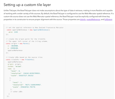

UndralBatsukh
Hi there,
The BaseTileLayer overview doc will be updated with the following info in version 4.33.
Screenshot 2025-04-22 at 2.03.54 PM.pngScreenshot 2025-04-22 at 2.03.54 PM.png
