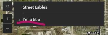

I'm attempting to remove an esri TileLayer from the legend. This does not remove it:
esriTileLayer = new TileLayer({
    url: "https://services.arcgisonline.com/arcgis/rest/services/World_Imagery/MapServer",
    legendEnabled: false,
    title: "I'm a title",

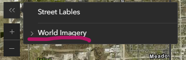

If I do not give it a title the default still appears:
    // title: "I'm a title",

Hi @JaredPilbeam2 ,
The screenshots show the LayerList widget/component.  If you want to hide the layer from being displayed in the LayerList you can use the listMode property.

AH, yes, it is a LayerList! Whoops.
