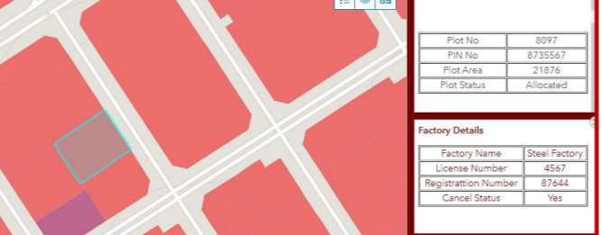

Hi
 We want to develop a print template as shown above where we get map and dynamic data into it. please suggest any ideas on it. we have gone through the customtextelements property in print parameters but no luck. please suggest on this.
When i try to get layout templates im getting below message. no custom text elements have been assigned. could anyone plz let me know how to configure that elements in it.

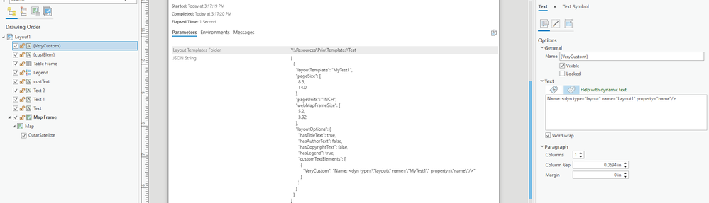

Hi Naveen,
Add the "{}" braces to the Text element name. this will provide you the custom Text Elements. Please refer to the attachment.customTextElement.PNG

naveenbesri
Thank you Kishore. I got it in customtextelements.
