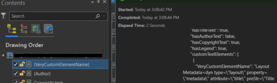

I was also perplexed by this vague description as well. Luckily I found the solution by looking at the default installation templates.
The name of the element is the Table of Contents when in Layout mode. Adding a open and closed curly bracket will add the element to the Print Layout Template JSON's "customTextElements" array.
Below is a screen capture of the "Get Layout Templates Info" which has successfully added the "{VeryCustomElementName}" dynamic element to the print template

Thank you very much @LongDinh
It's really easy but it wasn't obvious from the documentation.

The screen shot was the winning piece. Thanks for sharing that visual aid. Man, I've been stuck on this one... no more!
