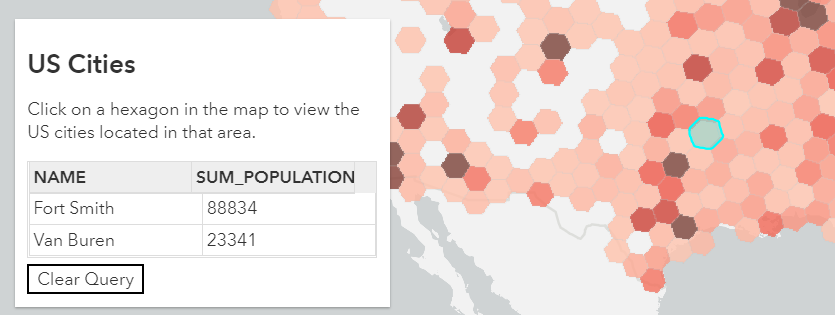

Hello, I'm trying to come up with custom field labels for my query widget in a map I'm creating. I'm using this sample code.
https://developers.arcgis.com/javascript/latest/sample-code/query-related-features/
When the query is run, the fields for the table appears as such:
My aim is to customize the field labels to show cleaner titles like, "City" for "NAME" and "Sum Population" instead of "SUM_POPULATION".
Would anyone know what I need to add and where to add it to achieve this goal?
The entire code for the aforementioned map is here.

I suppose there are many ways, but here's a simple example.  You would replace lines 181-192 (where the Grid is created) with the following, which uses a simple field name to field alias map:
grid = new Grid(
		columns: Object.keys(rows[0]).map(function (fieldName) {
			var fieldAliases = {
				"NAME": "City",
				"SUM_POPULATION": "Sum Population"
			return {
				label: fieldAliases[fieldName] || fieldName,
				field: fieldName,
				sortable: true
	gridDiv

Rice_GIS
Worked Great! Thank you so much!
