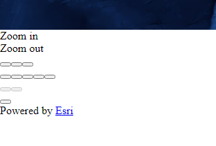

Hey,
I am using ArcGIS API for JavaScript 4.20 ES modules and I am trying to add a Sketch Widget to the top right corner. The standard buttons like Zoom in and Zoom out and the widget are not rendering properly. All I am getting is the following:
Like in the documentation i am adding CSS resource with @import "@arcgis/core/assets/esri/themes/light/main.css";
Nearly the same Code worked with 4.17.
My angular component below.

Hi Andy, at 4.17 it worked with AMD and for 4.20 I used ES modules, so only import statements and assets changed, core code is the same. I am in a security environment with no internet connection and own GIS Server. After copying the assets there are no exceptions or warnings so i have no clue why the rendering not like in 4.17

Okay, that's kind of what I figured, thanks for clarifying. It is odd that there are no 404, or even 504, errors when the app tries to retrieve the assets. One likely possibility is your assetsPath setting, the example above isn't what I would expect to see. Have you tried something like this:
esriConfig.assetsPath = "./assets";
If that doesn't work, send us a snippet of how you are copying the assets, such as your npm script, etc.

I tried in 2 seperate projects. In one project I use the:
"copyEsriAssets": "xcopy .\\node_modules\\@arcgis\\core\\assets .\\apps\\vwa\\src\\assets\\@arcgis\\core\\assets /sy"
In a second blank Angular project for testing I copied the assets (esri and components folder) manually to my-app\src\assets\@arcgis\core\assets and use
esriConfig.assetsPath = "./assets/@arcgis/core/assets";
I am sure the path is correct becauce if I change it I get a 404 for widget-assets not found and so on ...
So I am not sure about what is important next to the asset folder and the import of main.css
