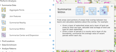

I should have asked this to start, but if you are using Online or Enterprise, you can use the Summarize Within analysis tool in the MapViewer Classic to do this. It will do counts and stats for you.
But you're on the right track, pre-processing is definitely the way to go if you can. I am not strong with Python though, I can fake it when I need to.
