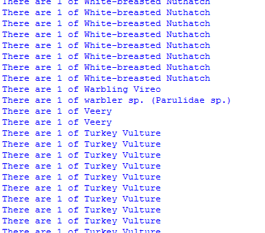

OK I am trying to get a tally of each species and their counts...
But I just get a big list of each one as it passes through the loop....not totals....where am I going wrong
# COUNT NUMBER OF RECORDS FOR EACH SPECIES
def unique_values(table, field):
    resultspecies = ""
    expressionValue = table
    species = field
    expressionValue2 = "common_name = '{}'".format(species)
    with arcpy.da.SearchCursor(Points, "common_name", where_clause=expressionValue2) as cursor:
      for row in cursor:
        resultspecies = row[0]
        rowCount = 0
        rowCount = rowCount + 1
    print "There are " + str(rowCount) + " of " + resultspecies
