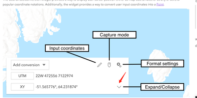

How to expand CoordinateConversion by default

There doesn't appear to be a documented way, but adding an "_expanded" property to your constructor will presently do the trick:
const ccWidget = new CoordinateConversion({
	view: view,
	_expanded: true

Thank you. If I want the default page to be input coordinates?
	view: view,
	_expanded: true,
	_inputVisible: true

How can I make this default to xy
	view: view,
	_expanded: true,
	_inputVisible: true,
	_conversionFormat: "BASEMAP"
