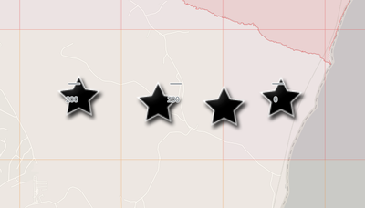

I'm having a similar issue:  I'm adding a graphic to my map, but it is not being placed above the labels.
If you go to this pen: https://codepen.io/ghoti143/pen/XWRBmOL?editors=1010 you can see that when clicking on the map, the black star shows up on top of everything except the numeric labels.
The labels are defined in a AGOL portal map.  I even tried using a client side feature layer as suggested, but to no avail.
