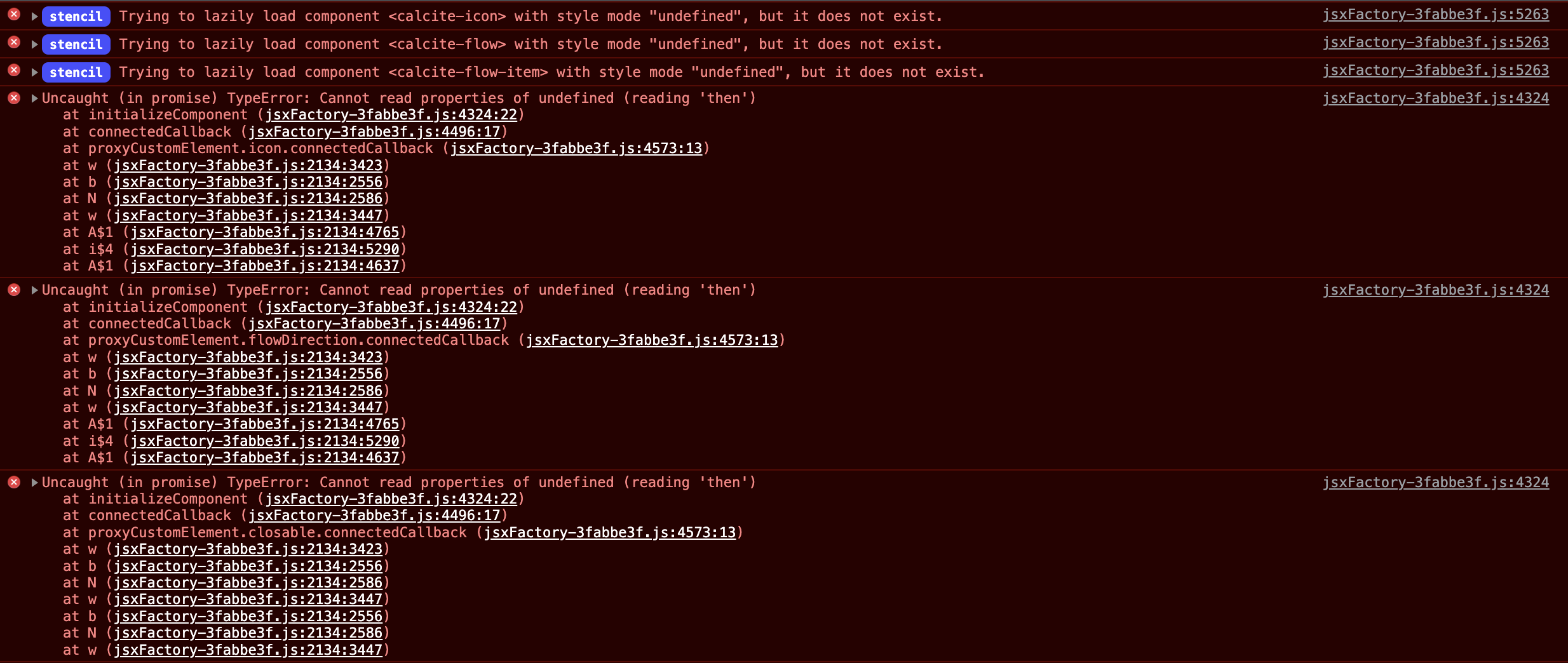

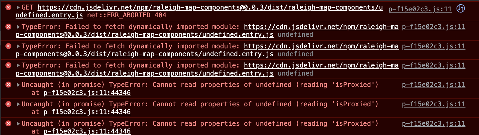

I get the following errors in the console when the popup appears:
So I thought it was an issue with the build process, but I am seeing the same issue locally and get the following errors about not being able to lazy load calcite-icon, calcite-flow, and calcite-flow-item:

Just imported @esri/calcite-components and set the asset path and that resolved the issue.  As a test, I just uninstalled it and rolled back to 4.24 and am not seeing the issue.  Since the errors were referring to calcite-flow, I'm wondering if this is related to the addition of the related records at 4.25 since it looks like that functionality uses the flow component.
Update: Just created a new React app, installed just @ArcGIS/core 4.25, without calcite-components and loaded the web map and don't see the issue, so it must be related to Stencil then.  Since installing calcite-components worked, I'll just keep that in there.  Thanks!

All good info, thanks for sharing your experience. Yes, there is a known issue with Stencil because it has it's own assetsPath setting that conflicts with  @ArcGIS/core.
