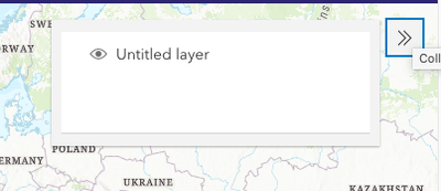

GroupLayer is visible in the LayerList even if it empty. You won't see the arrow to expand to see the layers in the GroupLayer because the layer is empty. If you drag and drop layers into the GroupLayer then you will see the arrow to expand. Not sure if this is what you are talking about.
With your code, you should see this when your app is initialized.
