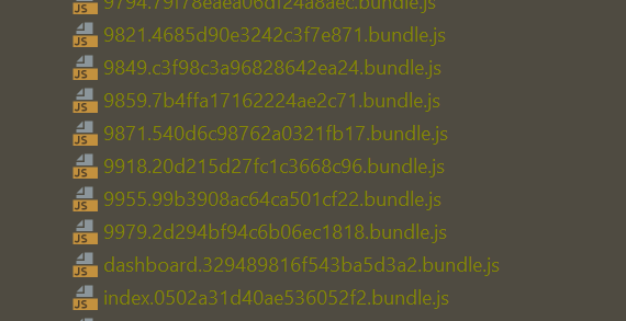

In the output, many bundle files are created from @arcgis/core. (They are mixed with my other bundle.js files. And I have multiple entry points.)
It looks a bit messy, is there a way to let webpack generate these bundle files into a sub-folder of my JS folder?

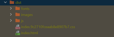

File structure of the dist folder:
Dist folder structureDist folder structure

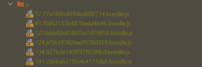

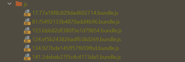

Generated bundle files:

This is expected behavior. The API takes advantage of dynamic import loading, especially when working with Portal items such as WebMap contents. The number of bundled files can vary from 200-300 depending on your tooling.
You can see a chart here of build metrics for various ESM samples we have.
https://github.com/Esri/jsapi-resources/blob/master/esm-samples/.metrics/4.22.2.csv
