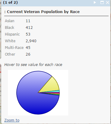

Maybe someone can spot what I'm missing.  I have a popupTemplate based on data that is from a linked table.  I am creating a pie chart.  All the values for the chart are in the join table, and from the layer, I just need county name.  Both the layer and the table are in a file geodatabase.

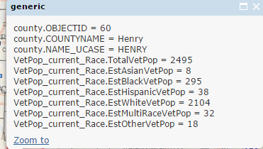

If I create a plain infoTemplate, defined as
var genericInfoTemplate = new InfoTemplate("generic", "${*}");
I can see all the values I want, both from the layer and the joined table.  The county name is available as county.COUNTYNAME
Here is my rest endpoint:
Layer: Veteran Population by Race - current (ID: 2)
Here is how I'm trying to defined my popupTemplate:
  var raceTemplate = new PopupTemplate({
    title: "{county.COUNTYNAME}: Current Veteran Population by Race",
    fieldInfos: [{
        fieldName: "VetPop_current_Race.EstAsianVetPop",
        visible: true,
        format: { places: 0 },
        label:"Asian"
        fieldName: "VetPop_current_Race.EstBlackVetPop",
        visible: true,
        label:"Black"
        fieldName: "VetPop_current_Race.EstHispanicVetPop",
        visible: true,
        label:"Hispanic"
        fieldName: "VetPop_current_Race.EstWhiteVetPop",
        visible: true,
        label:"White"
        fieldName: "VetPop_current_Race.EstMultiRaceVetPop",
        visible: true,
        label:"Multi-Race"
        fieldName: "VetPop_current_Race.EstOtherVetPop",
        visible: true,
        label:"Other"
    mediaInfos: [{
      type: "piechart",
      caption: "Hover to see value for each race",
        value: {
          fields: [
            "VetPop_current_Race.EstWhiteVetPop" ,
          theme: "PrimaryColors"
Besides not using PopupTemplates very often, this is also the first time I've defined infoTemplates in an ArcGISDynamicMapServiceLayer using myLayername.setInfoTemplates.  I don't know if that makes any difference or not.

Tracy,
  You just needed to include the county.COUNTYNAME field in your fieldInfos array
