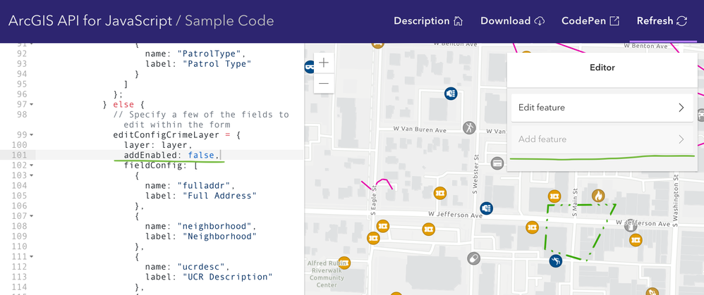

Thanks for the feedback @BrentGrossman and sorry I missed the fact that you also tried to pass addEnabled in the layerInfos. It would be good to see a complete sample as that should work. I've just tried it on the Configurable Editor Widget sample and this is what it looks like:
Using addEnabled on the layerInfos
Screen Shot 2021-11-22 at 3.40.15 PM.pngScreen Shot 2021-11-22 at 3.40.15 PM.png

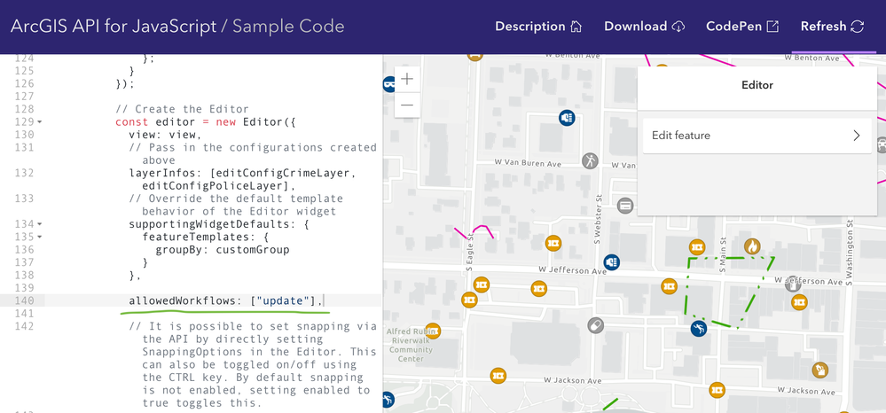

As @Kishore pointed out using allowedWorkflows directly on the Editor
Screen Shot 2021-11-22 at 3.40.50 PM.pngScreen Shot 2021-11-22 at 3.40.50 PM.png

@ArnoFiva, I was able to make "addEnabled: False" work on the Configurable Editor Widget sample, too, by putting it in both layers. My code gets many layers from the portal WebScene that it uses (most of which are not editable), so maybe that's the difference?
"allowedWorkflows" is a perfectly adequate solution for me, but I can probably provide more of my code, if you want to look at it to better understand why "addEnabled" didn't work for me, though I don't think I should post it here.
