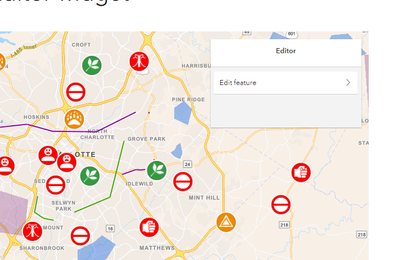

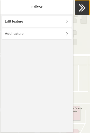

Here's what the Editor widget looks like when I run my code (it's in an Expand widget, as you can see):
Even if I can disable "Add feature", that's not ideal, since the button is still visible in that case. What I'd really like is to hide or remove that button altogether.

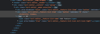

I added to the element  visibility: hidden;

@RickeyFight , this seems to work (though maybe there's a better way?):
.esri-editor__feature-list-item[role="button"]:nth-of-type(2) {
  visibility: hidden;
Thanks much for your help!
