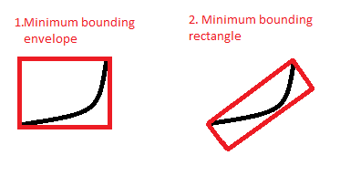

RiyasDeen
Hi Stephen,
1. One option is to get envelope of the buffer geometry, this will always be a 4 point rectangle.
2. If you are looking for a minimum bounding rectangle then you may want to create a geoprocessing service using minimum bounding geometry tool. Refer below links on how to go about it.
