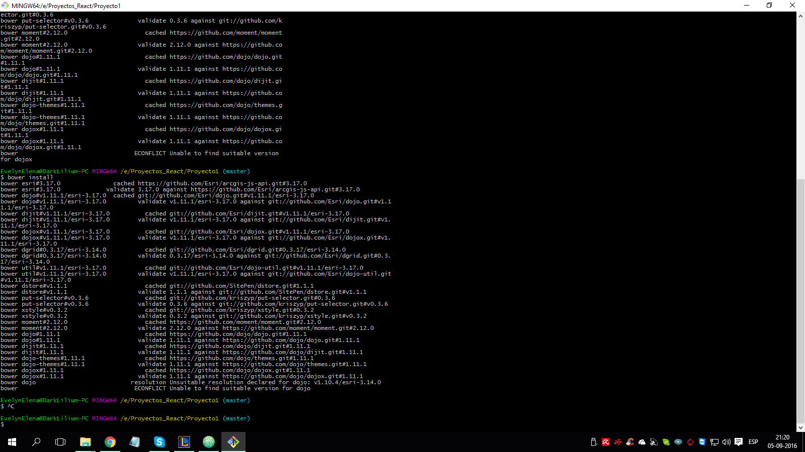

I have tried to install the api through bower but im having the following error
 ECONFLICT Unable to find suitable version for dojo
I read a topic about someone asking the same, but it doesnt allow me to select any option like her.
My bower.json file is this one:

Has this issue been resolved? I'm having the same problem.
EvelynHernandez
Actually im not using bower now , im using npm and some webpack configutation to make the arcgis js api work.
