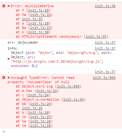

Hi guys,
I am facing the error "Cannot read property to lower case of null"  each time I reload the page and it solves when I refresh it, sometimes it takes several attempts to load the map and everything related to the arcgis API, ( the error is in the image below) ,I've heard it's because of the order of the libraries, that's why I am printing here my libraries.
Also I have an error that says "Multiple define' at the top of the console and as I know it's because of using both Dojo and jquery, (that error does not prevent the app from working) here is the order of my files:

I've solved that error changing the order of the files in order to call the JavaScript files first then the Arcgis API file like that :

EvelynHernandez
Yes, always the api at last
