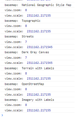

I have an application uses basemapGallery, I just realized two of the basemaps have zoomlevel setting diffferent from the rest basemaps. Is it normal?
Is there anyway to make the same zoomlevel for all basemaps?

Sorry,  i dont have an answer,  but I too have that issue with a custom "Home" button i built.   the "view.zoom" level is different between my 2 basemaps.  meaning clicking "Home" zooms differently depending on which basemap i have open.
Just echoing your issue.   good luck!

According to this API page:
  • Mapbox zoom levels are one value less than ArcGIS API zoom levels. The zoom level is based on a 256x256 pixel tile. Since Mapbox image tiles are 512x512 pixels, Mapbox zoom levels are 1 less than those of other APIs
I guess that's the reason of your problem.
ChelseaWu2
Thanks for the information. Your link is helpful.
But I am using only ArcGIS API.
Within ArcGIS API, depending on which base-map I loaded in, the zoom level is different.
I guess it was due to the basemap format
"The basemap styles service provides basemaps with layers formatted as either image tile layers or vector tile layers. When you use a basemap in your application, the scale of your zoom level will vary based on the type of layer the basemap uses. "
