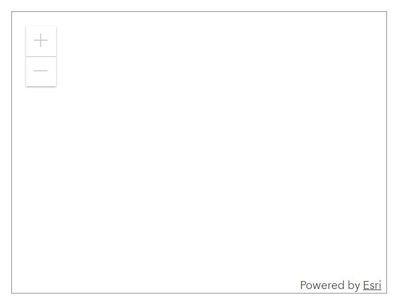

I'm attempting to deploy a simple web app built with ArcGIS Javascript API v4.23.  It's a React app that displays a single Map within a single MapView.
The problem I'm having is that the basemap tiles don't render when the app is deployed as a Docker container.  Has anyone else seen this?

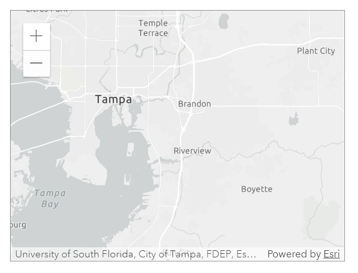

I can launch the app via localhost:3000 and everything works as expected.  The map renders within the correct div and it shows the gray canvas basemap tiles.  The CSS is also loading correctly and the zoom +/- buttons render correctly.  All of this correct behavior happens when the app is launched locally.  I can deploy it IIS or I can just run 'npm start' in VS Code and it runs without issues.  This is how it displays:
Code within the React app that creates the map and map view:

All of the above works when hosted locally or build and deployed to IIS.

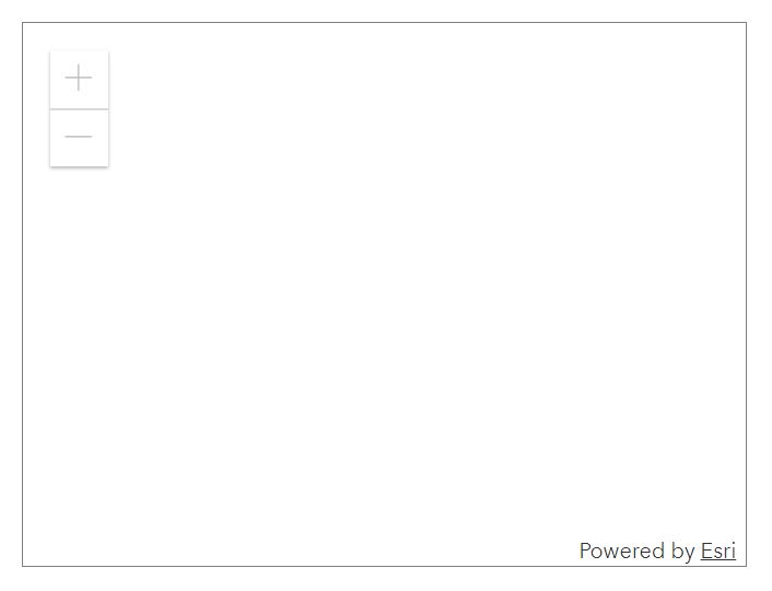

But the ultimate goal is to deploy this app within a Docker container.  The image builds successfully and also runs successfully, but when I browse the app running inside the container the basemap tiles don't render.
I get the same result in Chrome and Edge.  There are no errors or exception thrown in the browser's console.  It's as if the JS API is loading successfully but somehow the image tiles aren't rendering and I can't see any reason why this would fail only inside a Docker container.

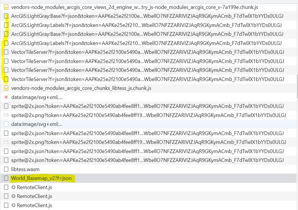

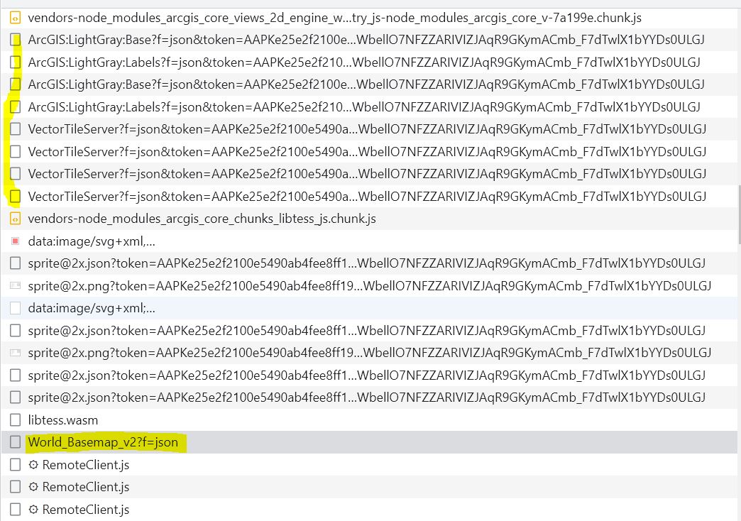

Update...

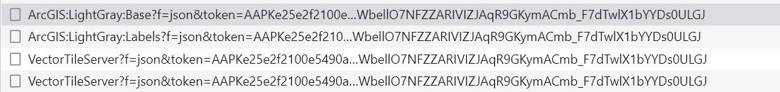

I noticed some differences in the requests being made by each version of this app.  In the network tab of Chrome's developer tools it looks like the app makes an extra call when running locally that is not made when it's running in a docker container.
Locally it makes two calls to LightGray:Base and LightGray:Labels, and also World_Basemap_v2 further down.
I see fewer calls for the light gray basemap resource in the Docker container and no request for World_Basemap_v2 at all.
Any help is appreciated.  Thanks.
