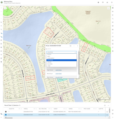

ForrestLin
This is how I create CustomContent (and PopupTemplate) using Angular component: PopupComponent.
import { Injector, Renderer2, RendererFactory2, inject } from "@angular/core";
import { NgElement, WithProperties, createCustomElement } from "@angular/elements";
import CustomContent from "@arcgis/core/popup/content/CustomContent";
_renderer2: Renderer2 = inject(RendererFactory2).createRenderer(null, null);
_injector = inject(Injector);
createPopupTemplate(): PopupTemplate {
    const popupTemplate = new PopupTemplate({
      title: this.title,
      outFields: ["*"],
      content: [this.createCustomContent()],
      actions: [],
      fieldInfos: []
    return popupTemplate;
  createCustomContent(): CustomContent {
    const customContent = new CustomContent({
      outFields: ["*"],
      creator: event => {
        this._graphic = event?.graphic;
        const popupEl = this.createPopupElement();
        return popupEl;
    return customContent;
  createPopupElement(): NgElement & WithProperties<PopupComponent> {
    if (!customElements.get('popup')) {
      const popupElement = createCustomElement(PopupComponent, { injector: this._injector });
      customElements.define('popup', popupElement);
    const popupElement: NgElement & WithProperties<PopupComponent> =                 this._renderer2.createElement('popup');
    return popupElement!;

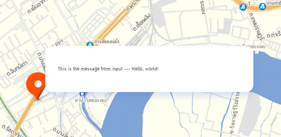

WoraminSat
Sorry for the late response. I have been very busy with my projects.
Anyway, I tried your example and adapt it to my code.
This is how I create from your example
TestPopupComponent (HTML & Typescript)
<p>This is the message from input --- {{message}}</p>
import { Component, Input } from '@angular/core';
@Component({
  selector: 'mea-test-popup-component',
  templateUrl: './test-popup-component.component.html',
  styleUrls: ['./test-popup-component.component.scss']
export class TestPopupComponentComponent {
  @Input() message: string = ''
 MainComponent
 import { Injector, Renderer2, RendererFactory2, inject } from '@angular/core';
import { NgElement, WithProperties, createCustomElement } from '@angular/elements';
import CustomContent from '@arcgis/core/popup/content/CustomContent';
import { TestPopupComponent } from './test-popup-component/test-popup.component';
//From mapView on click
displayPopup(mapPoint: Point){
        if (!customElements.get('mea-test-popup-component')) {
            const popupElement = createCustomElement(TestPopupComponent, { injector: this._injector });
            customElements.define('mea-test-popup-component', popupElement);
        const testComponent: NgElement & WithProperties<TestPopupComponent> = this._renderer2.createElement('mea-test-popup-component');
        testComponent.message = 'Hello, world!';
        this.mapView.openPopup({
            content: testComponent,
            location: mapPoint,
The Result
Thank you very much for your help!
