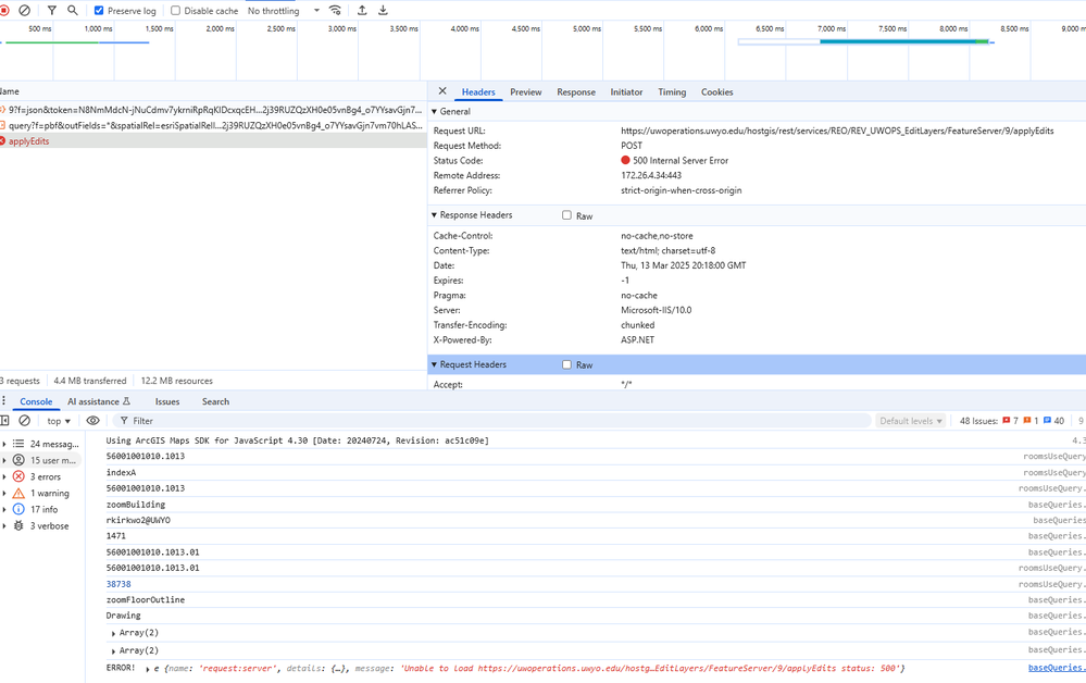

If you double-click on a request in the Network log, you'll see an additional set of tabs with information about the request...the Payload tab is in there.
Mr_Kirkwood

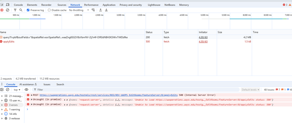

Thanks i see the Payload for the request above the applyEdits (query).  When i click on the request for applyEdits that goes away.
very strange it works for a single row using the original fucntion. I cannot get the new fucntion from above to just do a single row or single OBJECTID.

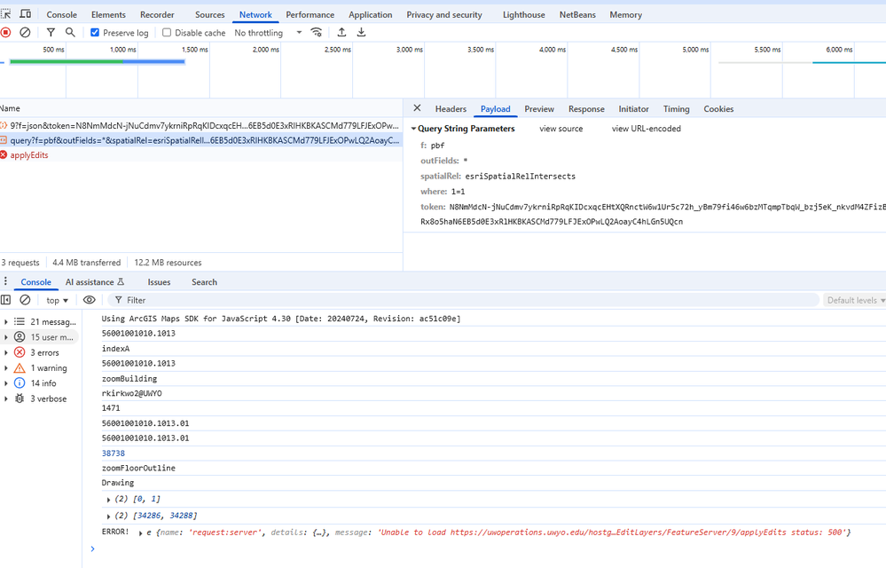

Maybe if you can post a screenshot of the payload tab for a request that works (single) and a request that fails (multiple) it might help reveal if the problem is on the application side.
Mr_Kirkwood
here is a screenshot
JoelBennett
MVP Regular Contributor
That shows the request for the query option that preceded applyEdits, but I would need to see the details for the applyEdits request.  That is, you'd need to double click the row for applyEdits.
Mr_Kirkwood
Joel,
Here is what it looks like when i double click the row on the applyEdits
JoelBennett
Ok, since there's no payload tab, I see what you were saying earlier about the tab going away.  Unfortunately, without it, it doesn't give us much to go on.  It makes me wonder if the request is being sent without the features being edited because if I understand it correctly, the Payload tab should still be there even if a POST request results in an HTTP 500.  This one may need Esri Technical Support if you have access to it.
