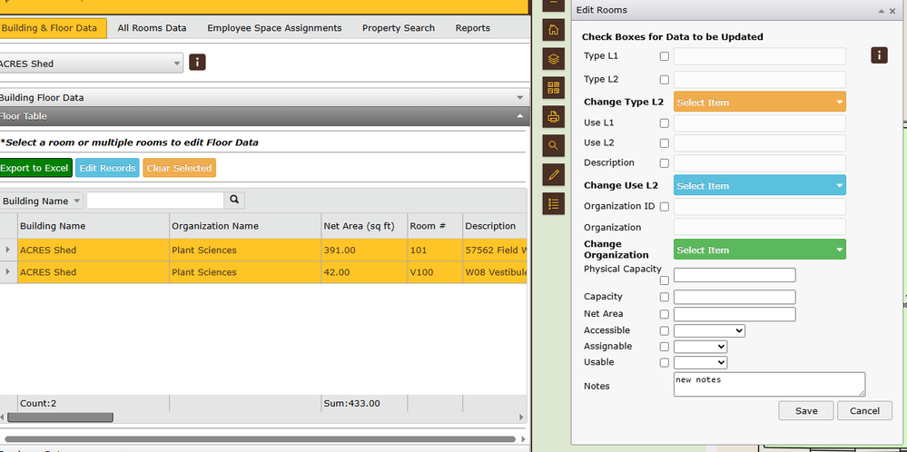

Mr_Kirkwood
Joel,
let me see if this is what you mean here is the Batch Edit function that i use to pass to the _applyUpdates:
function batchEditRoomData ()
    var objectIds = roomEditData;
    var batchEditRoom = {};
    batchEditRoom.NOTES = document.getElementById ('editroomDetails-NOTES').value;
     _applyUpdates(roomsTable, batchEditRoom, objectIds).then (function ()
        console.log ("Batch Edit Room");
I grab the OBJECTIDs from the table of  the selected records . I still seem to be getting an error . I am only using the NOTES field for this test, by the way.
