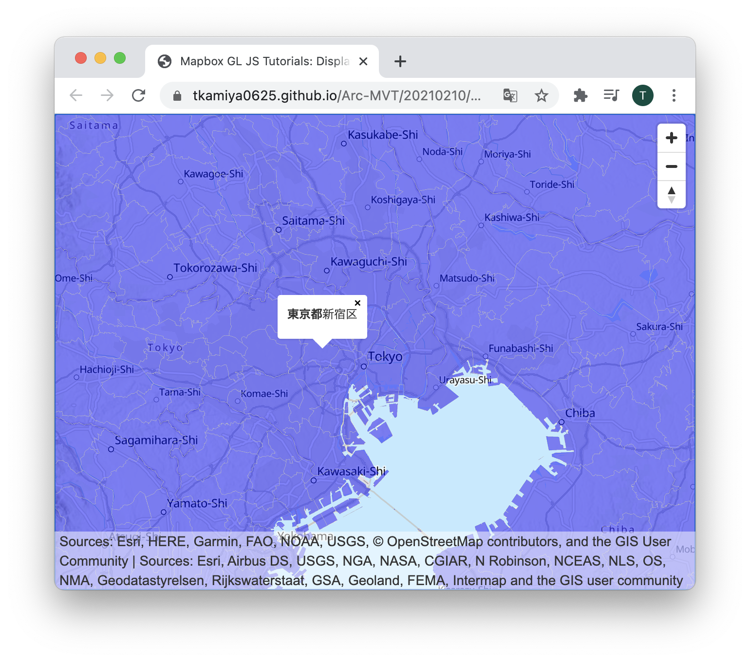

Hi,
As for the attribute data of MVT data, in Mapbox GL JS, I can get it as follows, but can't I get it in ArcGIS API for JavaScript?
map.on("click", "japan_ver821_layer", (e) => {
	const value = e.features[0];
	console.log(value)
	new mapboxgl.Popup()
		.setHTML(`<b>${value.properties.KEN}</b>${value.properties.SIKUCHOSON}`)
		.setLngLat(e.lngLat)
		.addTo(map);
