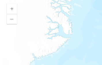

We just upgraded to 4.29. I understand that in 4.29, the Zoom/Compass buttons are switched to using Calcite Button with kind="neutral".
My issue is that the buttons now look out of place (see image below). The borders are white while the button itself is gray, whereas they used to be white in 4.28, matching the other widget action buttons.

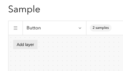

Looking at calcite button's documentation (2nd image below) this is the intended behavior for calcite-button (it uses --calcite-color-foreground-3 instead of foreground-1). However I'm quite sure this is not intended for the zoom/compass buttons, which should be actions that use foreground-1 instead.
Our app with 4.29:
Calcite button sample page with kind="neutral":

Hi, are you using the latest CSS for 4.29? Or what version of calcite components are you using? We recommend 2.4.0 or greater.
As you can see, the zoom widget does not appear gray in any of our samples.
https://developers.arcgis.com/javascript/latest/sample-code/intro-mapview/
