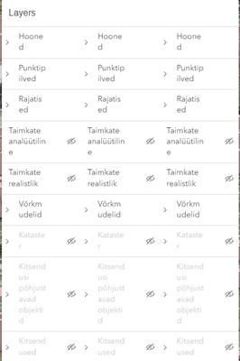

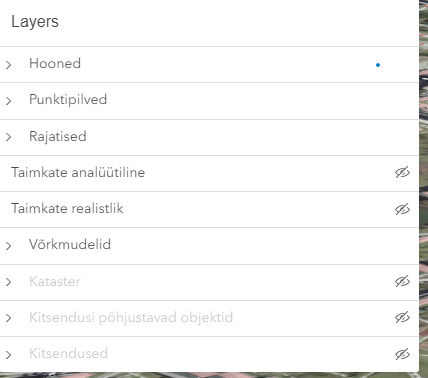

I have a problem using calcite-components-react with Vite dev server in HMR mode. The components, when applying changes or even on initial load, seem to get duplicated.
For example, the layerlist as shown here:
The current workaround is destroying the view with view.destroy() in useEffect cleanup, and then doing a full reload when changes are made, this at least assures that the components do not get duplicated, but it defeats the purpose of using HMR.

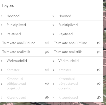

How it should look like:

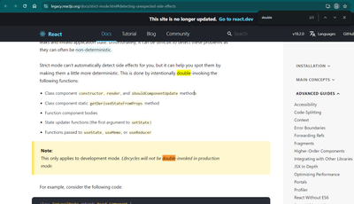

hey, the reason is you are running you app in strict mode.
comment these lines and app should work fine.

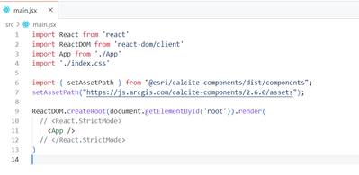

Disabling StrictMode does not work.
imritanshu

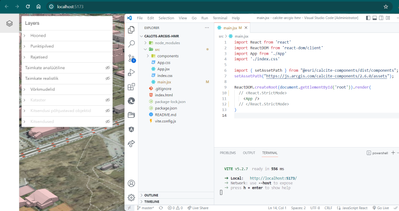

Probably you are doing something wrong. I cloned your sample and commented the strict mode. It is working without any issue.
Have a look.

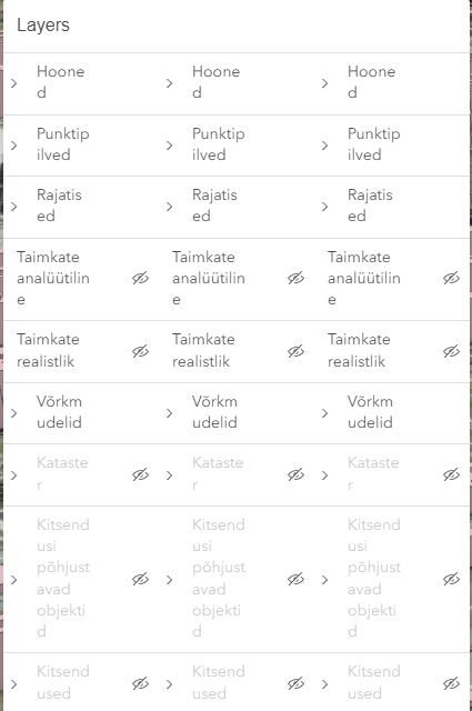

The first render is okay, so it would be the same as calling view.destroy(). However, when you modify App.jsx file in any way with dev server running (comments, new line, imports, etc), then it will cause the components to behave unexpectedly.
