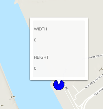

Initial popup state:

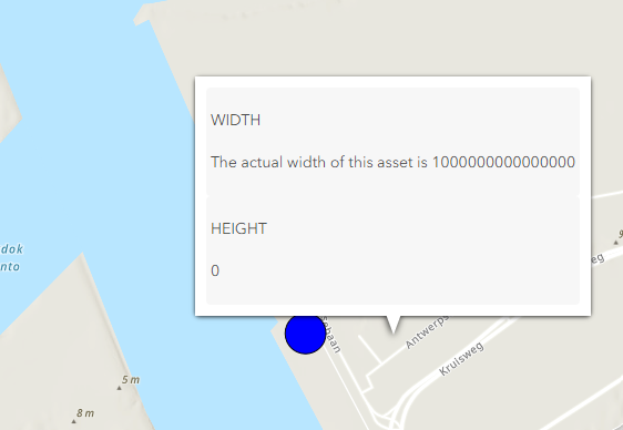

When data is loaded (async)
 The width of the popup should be auto (fit-content)
.esri-popup__main-container {
    width: auto !important;
It's only with version 4.27. The popup DOM element should be updated when the popup.content has changed. Can someone have a look? Thanks
