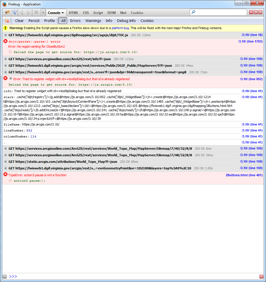

action3 = on.pausable(app.map, "click", function(evt) {
       executeIdentifyTask(map);  // Call Identify function
Your executeIdentifyTask is expecting an event, not a map.
function executeIdentifyTask (event) {
    identifyParams.geometry = event.mapPoint;

You should use a tool like Firebug. It shows that error
