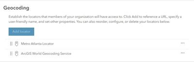

GISManager4
I added ArcGIS World Geocoding Service.
I opened a new tab for Instant Apps, went to the Address Lookup, and when I tired to open Search Settings, it froze up again. Do I need to delete the Metro Atlanta Locator? How will this change effect our other apps and maps that use the Metro Atlanta Locator (none of those are having issues.)

SarahMcDonald_Esri
Hi @GISManager4 ,
Looks like there is an issue with Nearby, Zone Lookup and Sidebar having a custom locator as the only locator service in the org. I was able to reproduce the behavior on my end when I was testing. The team is going to look into the issue.
As a workaround, I think you will need to have the ArcGIS World geocoding service added as a locator in the organization. Then in the app add the custom locator using the search configuration. As for the apps you have already created that are experiencing the issue, I haven't come across a way to get them up and running again so the best way forward is to create a new app and add the custom locator  in the search configuration settings.
