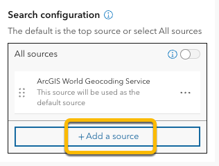

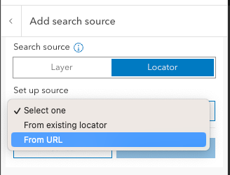

As a workaround, I think you will need to have the ArcGIS World geocoding service added as a locator in the organization. Then in the app add the custom locator using the search configuration. As for the apps you have already created that are experiencing the issue, I haven't come across a way to get them up and running again so the best way forward is to create a new app and add the custom locator  in the search configuration settings.

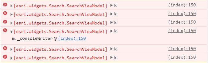

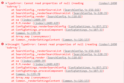

GISManager4
I am seeing errors.
