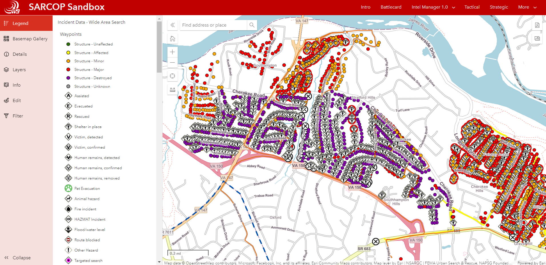

Urban Search & Rescue Task Force members collect waypoints and tracklogs in the field to show where they have been and what they've seen. Occasionally, the Plans Team Manager wants to edit or update the information from the Incident Command Post.
Technical Problem: We have used Web AppBuilder (WAB) in the past to allow for editing in a configuration, we call "Intel Manager". It has served us well, but we want to get ahead of the retirement and take advantage of editing and performance improvements in newer apps. (Sandbox https://experience.arcgis.com/experience/9051a07ffd1947bbb395e9f9b4088f85/page/Intel-Manager-1_0/
As we transition to Experience Builder over the next year (it will be considerable effort and there is missing functionality like copy features and batch attribute editing), we wanted to expose our users to the editing capabilities they'll be using in the future (which is MUCH improved with Javascript 4!!!). Sidebar Instant App looks like a good fit and we found it very quick & easy to configure.
Here is our "Intel Manager 2.0" configured with the Sidebar App https://experience.arcgis.com/experience/9051a07ffd1947bbb395e9f9b4088f85/page/Intel-Manager-2_0-Ins...
