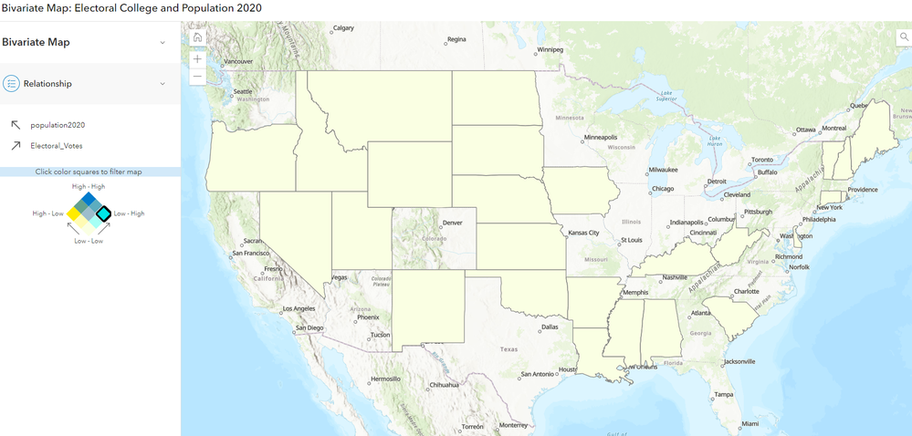

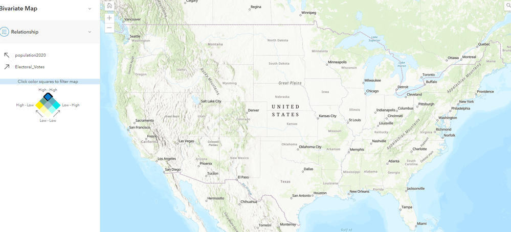

I created my first bivariate map and turned it into an instant app (Interactive Legend option).  When I click on the squares to filter the data, what I expect to happen doesn't.
Why is this happening?  How can I fix it?

Full map
Full mapFull map
When the high-high square is clicked, nothing is displayed. (unexpected result)
High-High (blue) square selectedHigh-High (blue) square selected

4 Replies
BethRomero
@JGVadnais1 , the app you linked is not shared publicly. Could you share it? I'm not able to reproduce that same behavior in my test.
JGVadnais1
Thanks for the heads up.  You should now have access.
BethRomero
@JGVadnais1 thanks for sharing your app.  This is an issue with the app when using vector polygon symbols. I will submit an issue; in the meantime, the workaround would be to use the basic polygon symbology.
