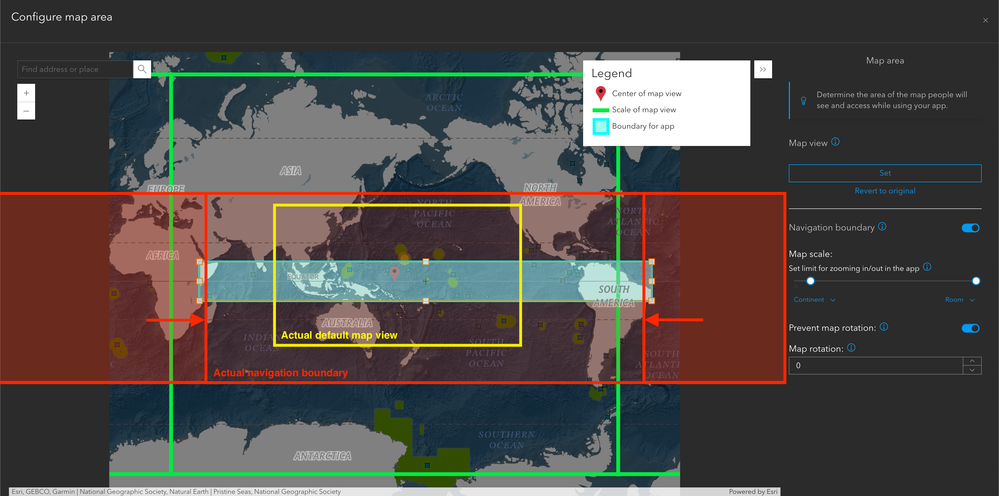

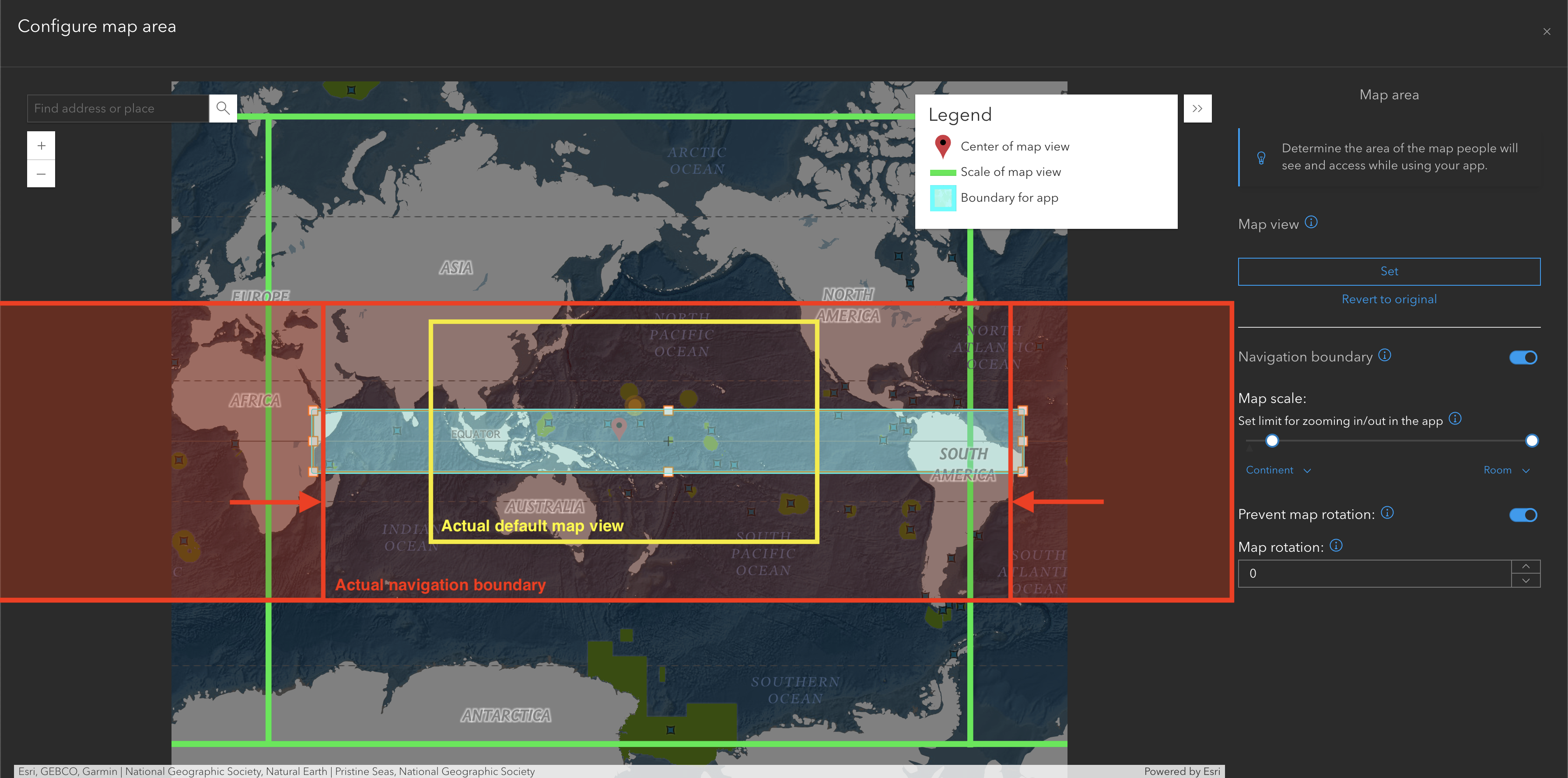

2. The Set button under Map view allows the user to directly adjust the app boundary (default map view) box using handles, but the resulting default map view doesn't match, even remotely. The user can set the map scale using the slider, but the green box never changes and it's unclear how the actual navigation boundary is affected by that setting. Here is a screenshot showing the settings as specified in the Map area wizard and the actual default map view (yellow box) and navigation boundary (red box) as seen when opening the app.

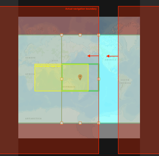

Thank you for your reply. Unfortunately, the map area wizard is not functioning for me as you described - the map views and navigation boundaries as set in the wizard do not correspond to what is shown on the published map (see below).

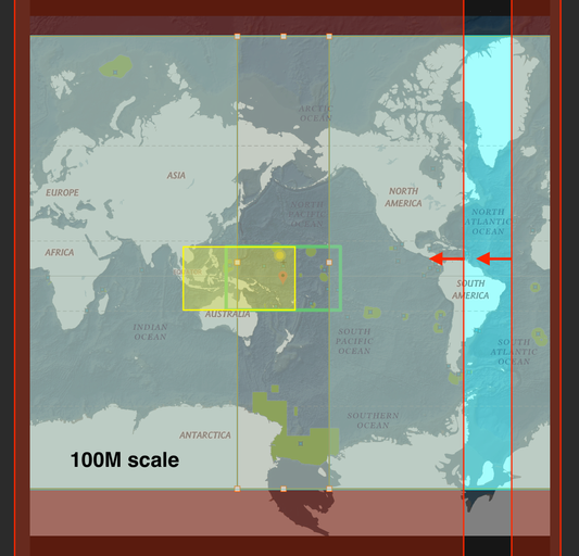

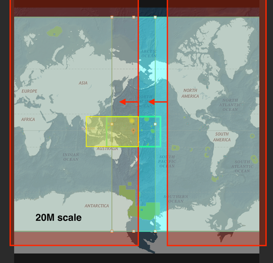

I followed your suggestion, but that hasn't solved the problems. Please see the two screenshots below. One is at a scale of 20M, one is at 100M, but I tried to keep everything else the same. The initial map views are the same between the two, but not lining up with the green box. The navigation boundaries are also different between the two, both in zoom (as expected, given the scale difference) and in extent in all directions.
