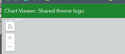

I've created a chart viewer instant app. The logo is missing and just shows the placeholder image and text which runs into the title in the header. I know it's in beta so I'm not sure if it's the app or on my end. I have a logo uploaded to my org and I don't see anywhere else to change the logo in the app config.

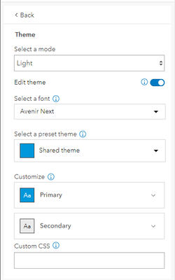

Within Chart Viewer's app configuration, you'll need to enable the 'Shared theme' setting.
If express setup is on, the setting will be in Theme & Layout.
If express setup is off, the setting will be in Theme & Layout > Theme.

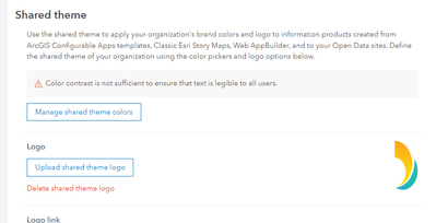

Thanks so much. For the benefit of anyone else reading this, I discovered that there are actually two places in the organization settings to upload a logo. I had one already loaded for the main account but there is also a place to upload a logo in the shared theme section in the settings. The second one is what appears in the app.

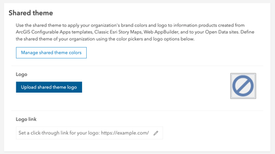

You can upload your organization logo located in the organization settings:
At that point, the logo should display in your app once the 'Apply shared theme' setting is on. In the near future, you will also have the option to upload a custom logo to your Instant App as well.
