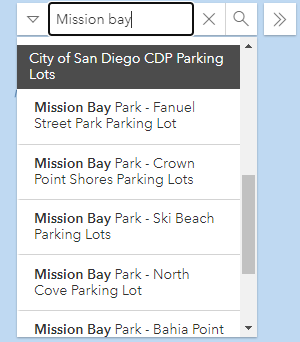

Can you test if your layer search Suggestions work as a "Contains"? I can only get my layer search to return results if I search the start of the string.
Example below, "Mission Bay" will return a bunch of results but we're wanting users to be able to type in "Fanuel" or "Crown Point" and have it suggest those results.

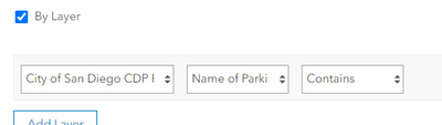

I have verified it is set to "Contains" in the map item settings:

KellyHutchins
Esri Notable Contributor
This is due to changes to the search widget behavior at the last release of ArcGIS Online. You can read more about that here: https://www.esri.com/arcgis-blog/products/arcgis-online/mapping/searching-for-features-in-maps-and-a...
