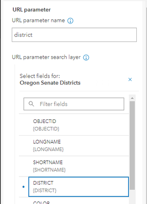

I have a Media Map configured with a URL parameter.
When I append &district=20 to the app URL the first time it loads it shows the typical map extent but if I refresh the page it loads the app zoomed into the feature I've specified with the URL parameter. Loading the app zoomed into the feature is the behavior I'd prefer. Is there a way to get that to happen on the first app load?

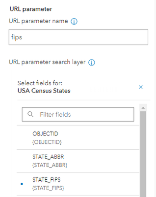

Hi @KellyHutchins. I was able to reproduce the behavior I was seeing in the app I shared in my last response. To do so I:
  1. Added the USA Census States layer to a map https://geo.maps.arcgis.com/home/item.html?id=774019f31f8549c39b5c72f149bbe74e
  2. Zoomed to the extent of the layer and saved the map.
  3. Clicked the Create App button in Map Viewer and chose Instant Apps then chose Media Map.
  4. Turned off express mode.
  5. Configured the URL parameter as shown
When I publish and first view https://geo.maps.arcgis.com/apps/instant/media/index.html?appid=52f91e058bca4538a7aae359f1c5847b then add &fips=11 to the URL the first time it loads it is zoomed out but when I refresh it zooms in.
