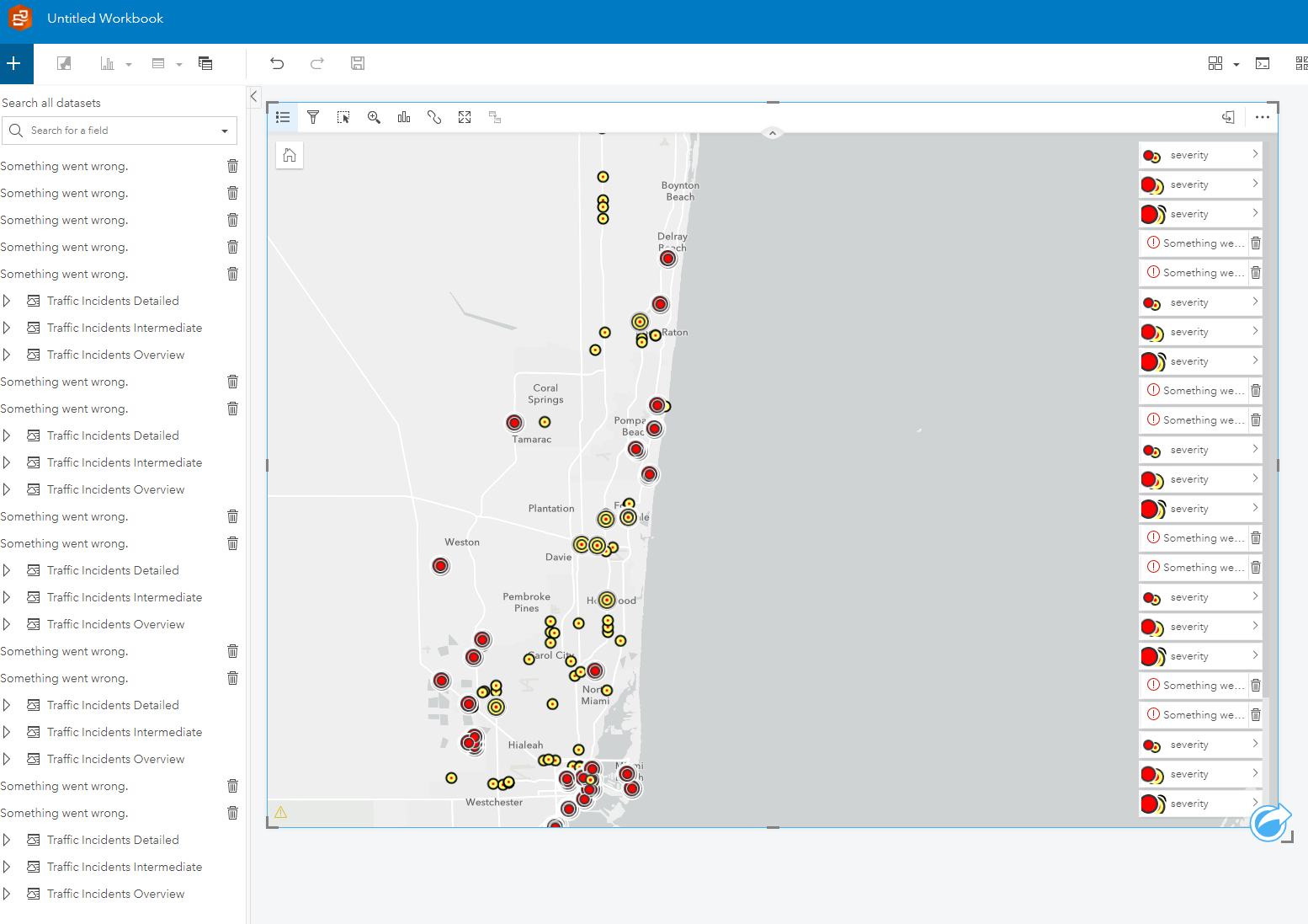

I am trying to add several Living Atlas live data feed layers into ArcInsights Desktop (latest version) but the first layer i.e., "World Traffic Service" (study area can be seen in the screenshot) fails to load completely (I think the line features are failing to load) as shown in the screenshot below.
How can I fix this?

... Completely random thought on the line features not showing before I sign off...
The lines aren't raster are they? Probably not, as raster lines don't make much sense, but raster data, as you know from an earlier post I recall, doesn't work in Insights. Wonder if that's why the lines aren't showing up.
