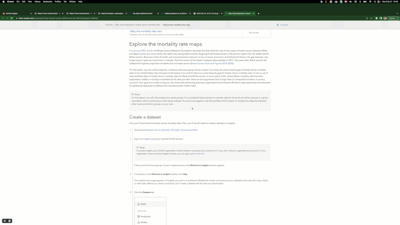

I will record and attach a short GIF of me downloading the data and opening it on Mac.
It's likely you've done all these steps the same, but just in case. 🙂
I hope this video helps!
Thanks for using ArcGIS Insights and sorry you ran into this issue, Dawn.
Please let the community know if you have any other questions!
Ian
P.S. If the embedded image is too small to make sense of, I attached the animated GIF as well.
