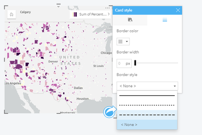

is there a way to removed the padding around a card
I don't believe we have padding around the cards. There are many creative ways to go about the presentation you can choose to remove the background or set the border to No borders from the card style.
You can also show or hide the card headers to make the card feel like floating in the work area
If you more questions about styling let's create another thread and keep this topic specific to the initial question.
