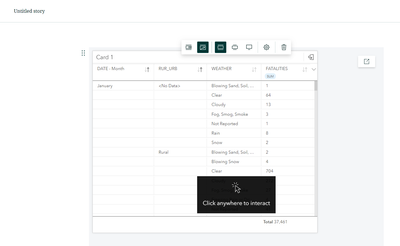

Let me also describe the steps I followed to embed a summary table in Insights into StoryMaps.
1. Create a summary or reference table using your data
2. Using the Publish button in the top right corner, share your report to your organization (or publicly if your data is public)
3. The Share dialog will update once the share succeeds, you can copy the embed code for StoryMaps:
4. Open the Storymaps app (on the same organization) > in Add content block, select Embed and paste the code from step 3
5. You should see the Insights report display with the interactive table, the size can be adjusted based on your needs:

RylandLu
I got it to embed properly thanks to the primer on custom versus default sizing Jennifer shared. Thanks again for all your help!
